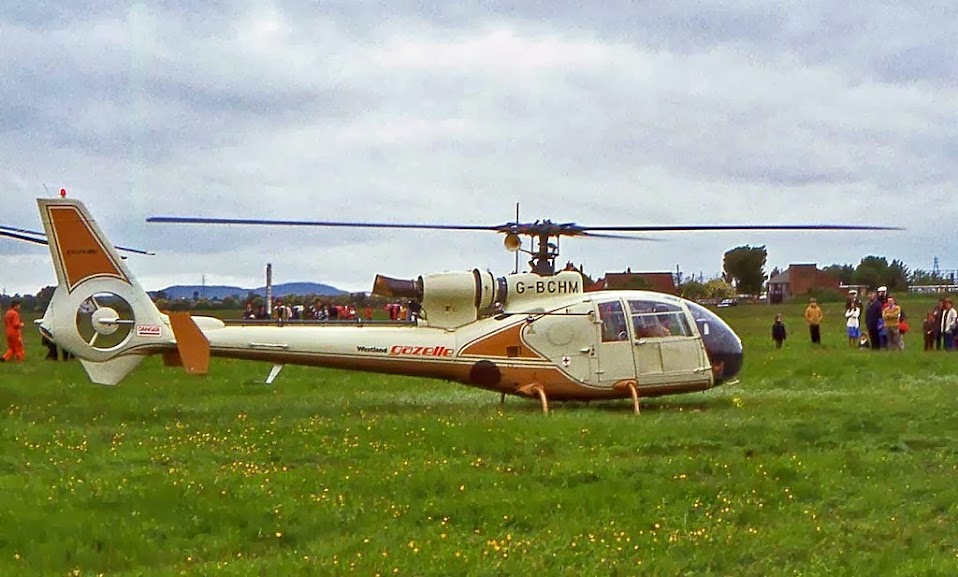

As mentioned above, the other Gaz my godfather flew besides G-BAGK was G-BCHM which was used, at some point and AFAIK, for part of Westland's developmental test flying.
SA341G G-BCHM as seen at Weston- super-Mare in the mid-1970's (Photo: Stuart Mitchell)
